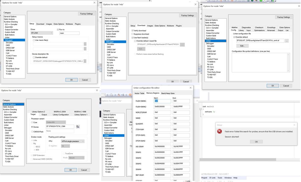

St link Utility is working properly. IAR works well with stm32f4. But it does not work with STM32H747 Disc0, please help me
PPaga.663
2 REPLIES 2
PPaga.663
Use STM32 Cube Programmer, not the Utilities. Use DLL and Drivers for V3. Apply patches to IAR.​
