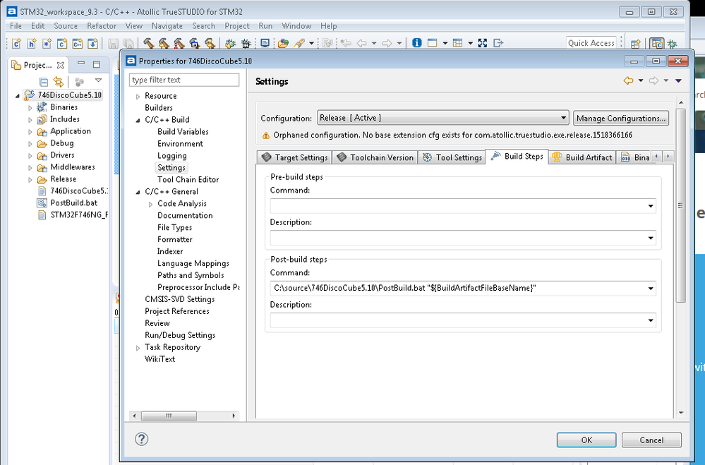

I had a problem with no elf file for a release build and I used the following:
​This was gleamed from a touchGFX project that a ST employee posted.
Create a bat file with...
arm-atollic-eabi-objcopy --remove-section=ExtFlashSection %1.elf intflash.elf
arm-atollic-eabi-objcopy -O binary intflash.elf intflash.bin
arm-atollic-eabi-objcopy -O binary --only-section=ExtFlashSection %1.elf extflash.bin
Then add the bat file to your build configuration (release)
Add the directory/file name of the hex file  to the command line. Then when you build the release, the elf file is created.

I didnt understand how to do these. I can only create a bat-file on the disk by external text editor.
In which section of the project settings it should be done?
-Add the directory/file name of the hex file  to the command line. Then when you build the release, the elf file is created.

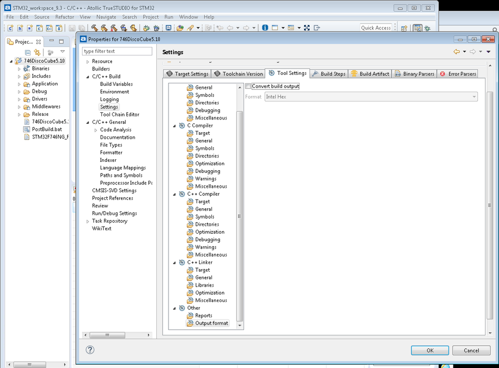

If you get a s record then maybe Convert is checked in the Output Format section?
Anyway PostBuild settings are in C/C++ Build->Settings, Build Steps Tab.
My bat file is in the project directory. Your directory names will be different.

I made the bat-file and put it in the project folder. In PostBuil  write commands it out. I tried several variation оf command but it did not work.
In C/C++ build/ settings/tool settings/ other/output format  was specified Intel hex, but in also not created.
