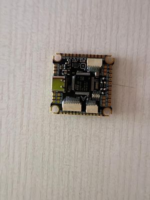

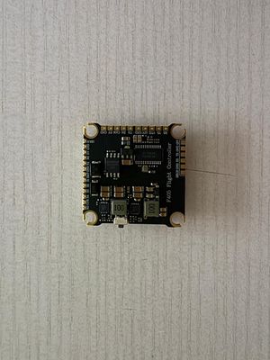

Photos of My Board: Here are photos of the top and bottom of my board. I'm hoping someone can recognize the exact layout or identify the gyro chip.
My Question: Does anyone have the original factory CLI dump or the correct .hex file for this specific "F4 V3S Plus" board? It seems I erased the custom configuration it needs to work.
Failing that, can anyone identify the gyro from the photos and suggest the correct target or custom settings I might need?
