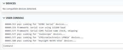

I am new to working with STM32 boards. I am trying to use the STM32H573I-DK as an interface board for the EEMBC EnergyRunner software. i am flashed firmware for benchmark into interface board
When I run EnergyRunner, it scans the serial ports but fails to recognize the board as show in the image:
please guide me to fix the this issue
thank you

Hello @maldoc and welcome to the community,
I advise you to follow this article "How to run a CoreMark® benchmark on an STM32" to perform CoreMark® benchmarks on an STM32H5 microcontroller.
This article guides you on how to perform CoreMark® benchmarks on an STM32H5 microcontroller. The STM32H563/73 has a CoreMark score of 1023 CoreMark® when running at 250MHz (4.092 CoreMark®/MHz) which is the same as the benchmark published on the EEMBC website.
I hope this help you.
Thank you.

Thanks @KDJEM.1 for your reply!. I will follow that article reference.
thank you gain.
