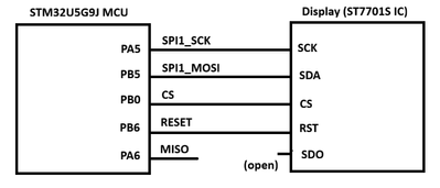

I have attached the output from a scope which is showing the SCK on the top input and the MOSI line on the lower input.  You can see there's no data on the lower input.
