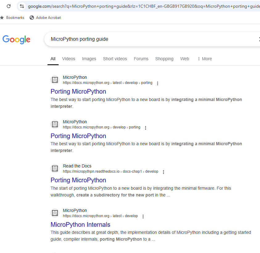

@Manu2Kumar wrote:
Is there any way to make support for STM32H753VI ? i mean how can i make the changes to make support STM32H753VI series i mean what are the files and what need to be considered to change accordingly? basically how to start :)
Again, you would have to ask the MicroPython people that - it's nothing to do with ST.
@ofer-bahar wrote:
and yet - no "cook book" is available
So get onto the MicroPython people about that!

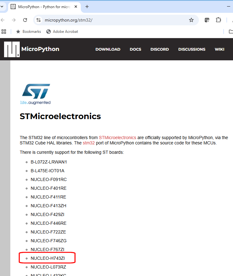

On a somewhat "hidden" page, the micropython website states the following : https://micropython.org/stm32/
The STM32 line of microcontrollers from STMicroelectronics are officially supported by MicroPython, via the STM32 Cube HAL libraries. The stm32 port of MicroPython contains the source code for these MCUs.
There is currently support for the following ST boards:
The official reference hardware for MicroPython is the pyboard which contains an STM32F405 microcontroller.
Notice, the list of boards contains no H variant at all.
If I remember correctly, these ports were mostly supplied by ST itself at that time.
It seems this support has not paid off economically, and was terminated by ST - solely my conclusion, though.
Long story short, unless you do the portyourself, I see little chance to use it on your H7 board.
I would consider other options - either a board with micropython support out of the box, or an alternative like circuitpython, as Andrew Neil suggests
After all, you want to use a high-level language that abstracts all of the low-level and peripheral register stuff for you. No point in obsessing about certain MCU variants.

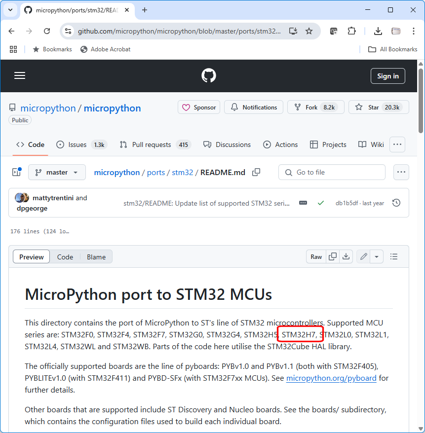

Oh yes it does:
and their GitHub says "H7" generically:

You are right, I overlooked the listed H7 variant - sorry.
Nonetheless, it seems ST has more or less abandoned this micropython project.
I would consider it more of a prototyping tool anyway, probably less in demand by commercial customers.
