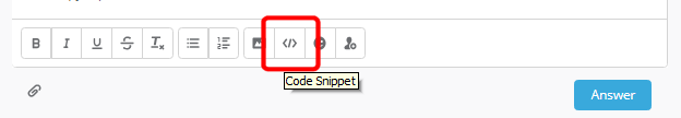

On this forum, use this button to properly post source code:
