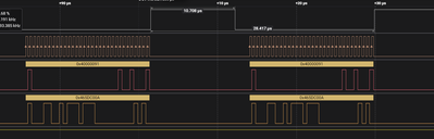

I am trying to interface STM32H7 microcontroller with SCL3300 inclinometer, I have attached the SPI configuration and the SPItransfer method.

 I am trying to send WHOAMI twice and when I look at the second frame my CRC almost always fails. If anyone can highlight why my CRC fails.
Attaching screenshot of my logic analyzer. CS, SCK, MOSI , MISO respectively.
Thank you

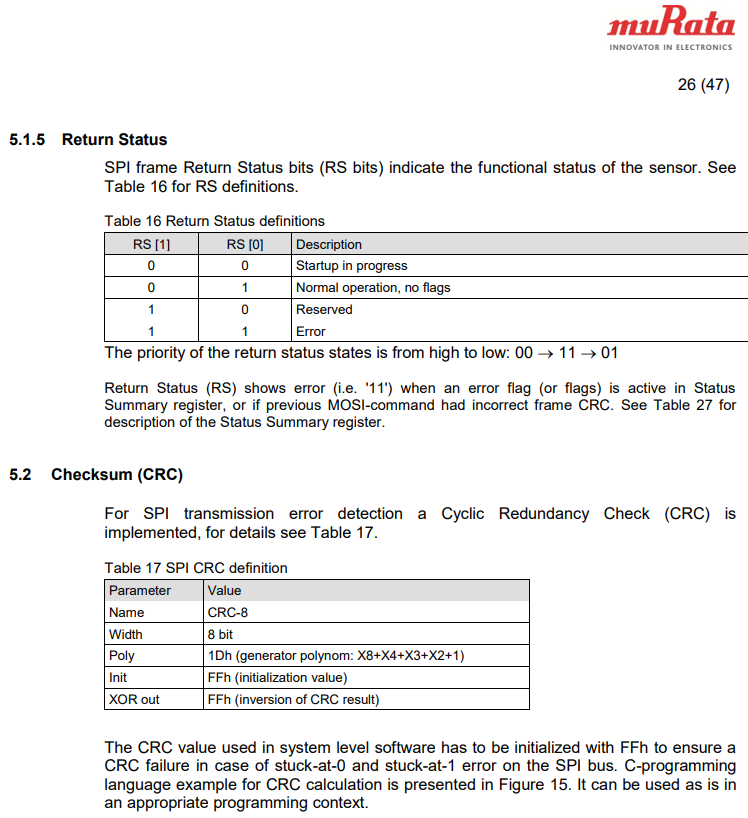

Andrew Neil
Are you sure you are using the correct CRC (with correct initialisation), as described in the Murata datasheet?
https://www.murata.com/-/media/webrenewal/products/sensor/pdf/datasheet/datasheet_scl3300-d01.ashx?la=en&cvid=20231213062930000000#page=26
via: https://www.murata.com/en-eu/products/sensor/inclinometer/overview/lineup/scl3300
Have you tried using the C implementation which they provide?
sundar_
Yes I am using the same implementation that is in the datasheet
