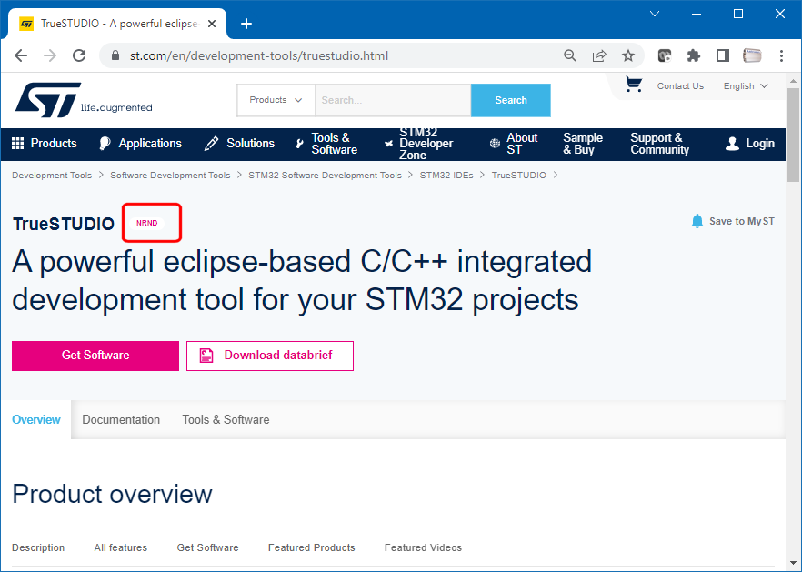

TRUEStudio is Not Recommended for New Designs (NRND) - STM32CubeIDE is the replacement:
