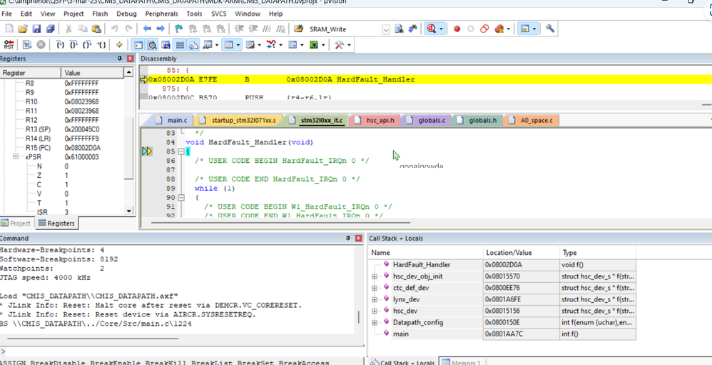

code crashes and lead to Hardfault when I include I2C1_IRQ_handler.
GR.5
Hi guys,
I using
keil uvisionV5.35.0.0
arm_compiler : V6.16
We are developing a project on STM32L071CZYx MCU. which has
flash memory: 192kB
RAM: 20KB
I have attached a I2C1_IRQhandler function for your reference.

here I2C1 is configured has a slave.
without I2C_IRQ_handler function I2C1 will work well in polling mode.
Code crashes and lead to hardfault at hsc_dev_obj_init when I include I2C1_IRQ_handler function.
0693W00000aIoTnQAK.pngI have tried all the ways like increasing stack memory and reducing global variables but nothing works. please help me to resolve this error.

Foued_KH
Hello @GR.5​ ,
Please check the LR register content (in CPU registers), if :
  • 0xFFFF-FFF1: Handler stack
  • 0xFFFF-FFF9 : main stack
  • 0xFFFF-FFFD : process stack
If main stack => copy the @ in the main stack register and paste it in the memory view .
Copy the PC content and paste it in the disassembly viewer and see the instruction that cause the HardaFault
Foued
GR.5
Hi KHALSI_Foued Thanks for your reply,
As we can see above the LR register value is 0xFFFF-FFF9 and call stack local is showing hsc_dev_obj_init lead to the hardfault your suggesting that there is problem in handling main stack (may be stack overflow) so I have tried to increase the stack size and reduce the global variables in the program but still not working.
I don't know how I2C1_IRQ_handler is causing the problem?
Regards,
Gopal Gowda

I have attached a function at which I am getting Hardfault.
hsc_dev_t* hsc_dev_obj_init(struct hsc_dev_cls *dev, uint32_t asic_id)
    /* Initialize */
    HSC_MEMSET(dev, 0x0, sizeof(struct hsc_dev_cls));
    dev->ops = NULL;
    dev->asic_id = asic_id;
    dev->pkg_type = 0;
    return (hsc_dev_t*) dev;
But there won't be any crash in code if I don't add I2C1_IRQhandler function
only when I include I2C1_IRQhandler function It crashes.
 I don't know How I2C1_IRQhandler function is responsible for crash.
Regards,
Gopal Gowda
GR.5
Hi Krani thank you for reply,
can u elaborate please.
do you mean to display all the registers like R0 R1 R2 R3 R12 LR SP PC registers in the hard fault function.?
In Debug mode I executed step by step instructions when I try to execute
dev->ops = NULL of hsc_dev_obj_init function it is leading to hardfault.
Bob S
Search these forums, or even the Keil website for fault handler code. @Community member​ has posted several (many????) of them here. Not just CPU registers but the memory management/fault registers.
Hmmm... I've never used uVision on ARM chips, but doesn't it have a fault analysis window somewhere in their IDE?
Sanity check the pointer "dev", ie its not NULL, misaligned, pointing outside of RAM
