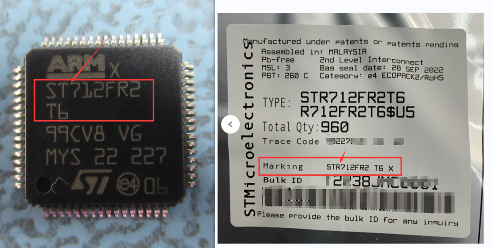

Why there is an inconsistent bewteen the label information and the marking information?
EJian.2
Why there is an inconsistent bewteen the label information and the marking information?We find the marking should be ,Judging from the label, its marking should be "STR712FR2", but actually its marking on the device is "ST712FR2".Why? If this is normal?0693W00000VO8ZQQA1.png
5 REPLIES 5
Peter BENSCH
The STR712FR2 has long been discontinued, but there were several variants of the STR712FR2T6, including one with suffix $U5. This suffix has no technical relevance and is only used internally.
It is correct, however, that the laser marking on the $U5 variant was ST712FR2, on other variants also STR712FR2. Since these parts have long been discontinued, it is unfortunately no longer possible to determine why a different marking is printed on the label.
Does it answer your question?
Regards
/Peter
