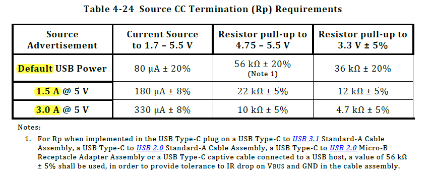

What is the meaning for SNK.Power1.5 and SNK.Power3.0? What is the meaning for "Above minimum vRd-Connect"?
I found that when I connect to a PC USB-A port, CC_STATUS(0x11)  is always 0x11; While when I connect to a lab power supply, CC_STATUS(0x11)  is always 0x13. Is it guaranteed?

The USB-C specification defines 3 possible currents at 5V provided by the Power Source:
  • Default power (i.e. legacy from USB2.0)
  • 1.5A
  • 3.0A
So the CC1_STATE and CC2_STATE bits from STUSB4500 register indicate what is the maximum current at 5V that the USB-C Source can provide to your SINK application.
  • I found that when I connect to a PC USB-A port, CC_STATUS(0x11) is always 0x11; While when I connect to a lab power supply, CC_STATUS(0x11) is always 0x13. Is it guaranteed?
A legacy USB Type-A will always have the value: SNK.Default because it can only provide the default power before USB-C was created.
However for a USB-C port, you cannot know in advance if it will provide 1.5A or 3.0A maximum. That’s why you need to use the CC1_STATE register to determine if the USB-C source that you are connected to can provide enough current.

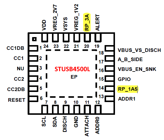

A simpler way to implement this is to use the STUSB4500L version, which has dedicated GPIO pins (RP_1A5 and RP_3A pins) to tell you if the USB-C can provide 1.5A or 3.0A.
https://www.st.com/en/interfaces-and-transceivers/stusb4500l.html

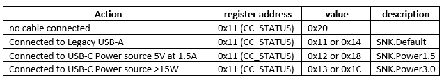

We are using STUSB4500(Not the STUSB4500L version) with external lab supply power. When I set the lab power supply to 5V, for some of our boards, CC_STATUS reads out as 0x13 (which means it provide 3A), but for some boards, CC_STATUS reads out 0x11 (means legacy USB2.0 default power). My question is: based on what condition does STUSB4500 fill out CC_STATUS? How does STUSB4500 know the power source is legacy USB 2.0 or lab power supply?
Another question is that, when I turn up the table power supply voltage, say to 7V, for all our boards, CC_STATUS reads out 0x20. What does it mean and how to make it go out of the state (the last 2 bits are zeros and are reserved)?

  • How does STUSB4500 know the power source is legacy USB 2.0 or lab power supply?
The STUSB4500 detects on the CC pin the pull-up resistor value located on the USB-C SOURCE side, and fill the appropriate register.
  • Another question is that, when I turn up the table power supply voltage, say to 7V, for all our boards, CC_STATUS reads out 0x20. What does it mean and how to make it go out of the state (the last 2 bits are zeros and are reserved)?
The VBUS voltage is supposed to start at 5V. If you provide 7V instead, the STUSB4500 will detect an incorrect voltage and won’t establish a correct connection. So it is as if the cable was not properly connected.
