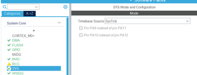

Could someone please explain the meaning of this image? It's a snapshot from CubeMX GPIO section.
Does it imply that PA12 and PA10 can be used as a single pin, or does it mean something else?

The reason I am asking is I am not able to Turn ON OR Toggle the pin PA12 I don't understand the reason why this pin gives me problem
August 1, 2025
By default, those pins are PA11 and PA12. You can set them as PA9 and PA10 instead with these checkboxes:

I have not clicked on the checkbox still my PA12 pin is not used as output I have tried toggling to this pin, to verify my toggling is Ok I selected another pin which works ok but when I am going to use PA12 The pin is not toggling You can see in my attached image
Also, if I try to click on the check boxes then I cannot be able to click it looks like these checkboxes are disabled
August 7, 2025
Show your board, schematic, connections, etc. You're missing something in there.
Include your IOC.
