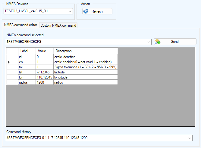

However, now I got another issue. I'm trying to set geofence using $PSTMGEOFENCECFG and it says $PSTMGEOFENCECFGERROR*06 and here's the command that I sent to my Teseo.
0693W00000YAX4uQAH.pngDo you know where did I go wrong? I'm kinda lost since it only says error without any details.
AVike.1
May be, ID should start from 1?
AVike.1
And radius value format as double: 1200.0?
