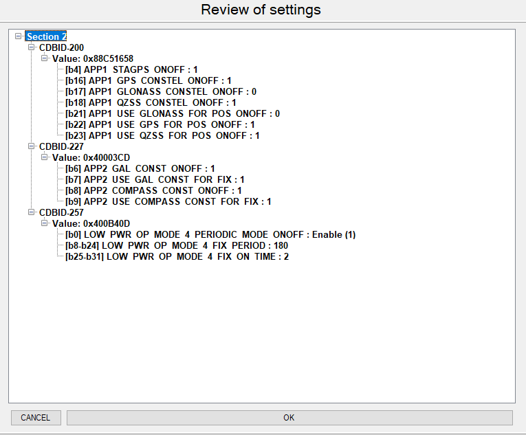

I have a Teseo-LIV3FL GNSS Module and I want to configure the low power mode configuration using Teseo Suite software. Here's my setting
0693W00000YA3nxQAD.pngI was expecting after two fix reports my Teseo will go to sleep mode in 180 seconds, but after getting bunch of fix messages my module didn't go to sleep mode (still running in normal working current). Where did I go wrong?
