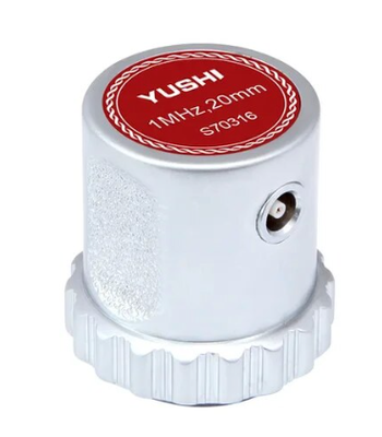

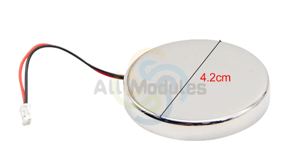

Is your piezo something like this:
or this:
(from Ali express , you should find it more easy than me...)
And there is the driver inside, maybe 10W  max. ; but i would guess, interesting to learn how they do.

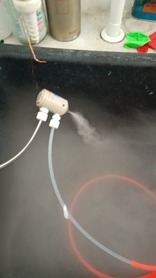

The shape of the ultrasonic is as follows:
