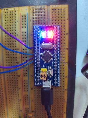

@NicoNX650 wrote:
The boards are two STM32F103CBT6A.
That's not a board - that's just the part number of the MCU chip.
You need to give details of the board on which the chip is mounted.
How to write your question to maximize your chances to find a solution
Dear Andrew,
you're right. If I remember well the board name is Blue Pill.
For be sure I attached the picture of them.
Thanks
