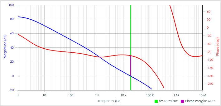

I'm trying stability analysis phase margin and gain margin for A6985 on the eDesignSuite.
I understand that phase ​margin and fc are showed in bode plot diagram but gain margin is not displayed.
and I cannot estimate it manually due to vertical axis shows less than -20dB.
Do you have any idea to get a gain margin or to extend vertical axis?
