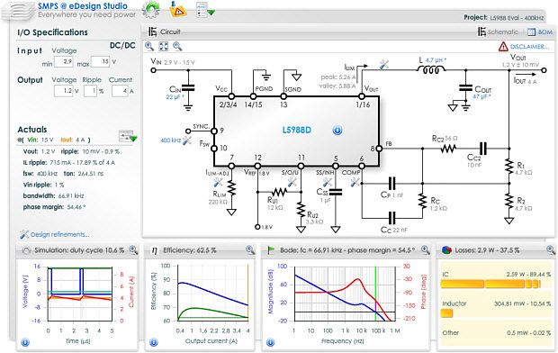

eDesignStudio simplifies power supply design and offers to designers the flexibility to choose the right products and topologies.
A full design is generated from the high-level requirements specified by user and provides:
  • all relevant parameters and results
  • a full and interactive schematic
  • a full and interactive bill of materials (BOM)
  • a full set of analysis diagrams
The user can fine tune the proposed design by adding more advanced constrains for stability performance and component selection.
