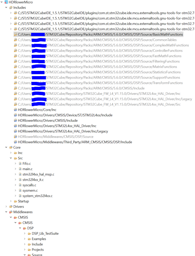

I am importing a project that a colleague made. The project seems to be missing a lot of include files, I know I have the correct libraries in my repository but the project can't seem to find them. It seems like the filepath is pointing to C:/users/colleague/STM32Cube....
but I need to change it to C:/users/myUsername/STM32Cube....
Some of the CDT build console errors:

This is a screenshot from my project explorer:
How do I resolve include issues like this?

Probably should consider putting shared projects and repositories in a common directory both can access.
The project file is likely XML/ASCII open in a text editor and search/replace \user\blokeone\ for \user\bloketwo\

Ok that seems to have eliminated most of the errors. I'm getting a new one now though:
0693W000007DSSvQAO.pngThe filepath is addressing the right user now (me). I think this new error is caused by using a different compiler than the one originally used by the project creator. I tried cleaning and building but no luck.
