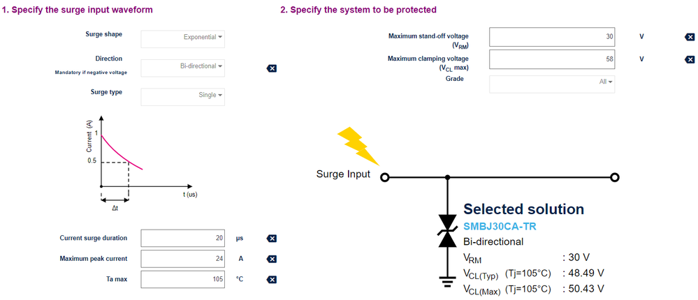

Applications conditions for protection:
Vin_max = 30 V
Vin_absolute = 58 V
Tamb_max = 105 °C
Max surge current for 8/20 μs pulse wave:
Isurge_max = 1 kV / 42 Ohm = 24 A

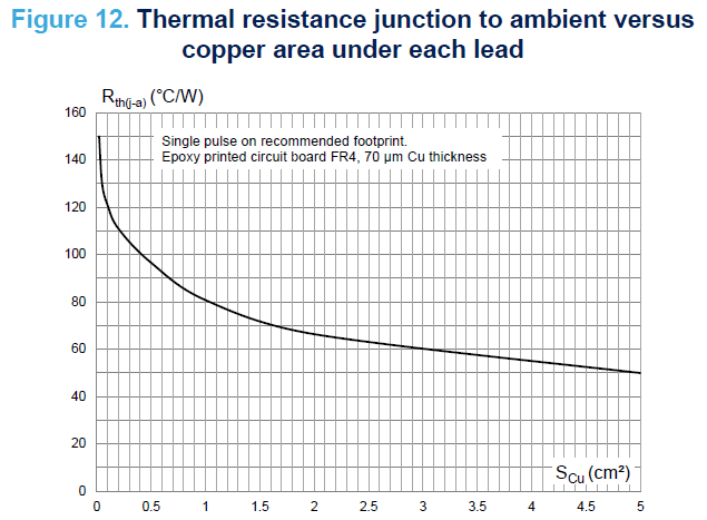

Rthja = 150 °C/W from Figure 12

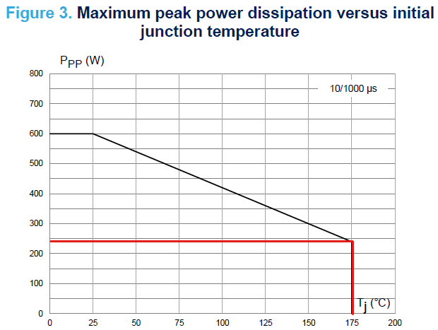

Ppp_DR = Ppp_DS x (240 / 600) = 4000 x (240 / 600) = 1600 W for Tj = 175 °C from Figure 3
Tj = Tamb + ( Ppp_DR x Rthja ) = 105 + ( 1600 x 150 ) = ??? ---> thats not possible

  3. Figure 12 is useful for repetitive surges (additional copper surface can be needed to dissipate average power to have average junction temperature lower than Tj_max). It is not your case because you consider only a single pulse
  4. Figure 13 is useful for single surge (your case). Your comment is fair but peak junction temperature can be higher than Tj_max for a single pulse. As example, with 175°C ambient temperature, it is possible the dissipate 240W (instead of 600W at 25°C) and that dissipation due to the single pulse will increase junction temperature.

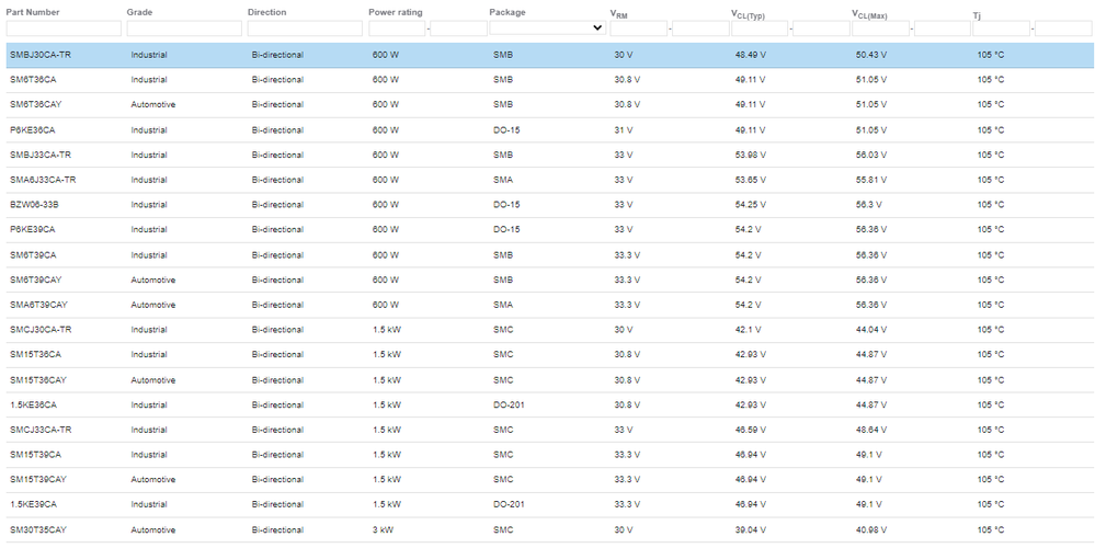

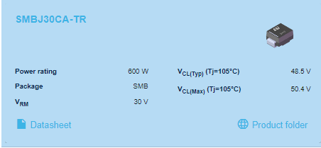

To perform all calculation, you can use TVS Simulator.
According to your conditions, SMBJ30CA is recommended.

Reha
Dear Mathieu,
thank you for your fast answer. The simulation tool is very easy to find out a suitable TVS diode.
