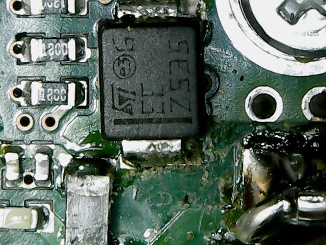

help. I need the specification sheet for this diode Z535 (attached photo), I understand that it is discontinued. Can you tell me what diode to replace it with?
SNEQU.1
SM6T18A EE
4 REPLIES 4
SM6T18A EE
SNEQU.1
THANKS. you have the datasheet for Z535
Z535 is a Production/Date code
https://www.mouser.com/ProductDetail/STMicroelectronics/SM6T18A?qs=ZN9SVtODT3wrWCPT8iGtBA%3D%3D
SNEQU.1
TANKS SO MUCH!!!
