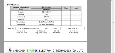

It looks like you're using the wrong address, GOODIX is using 0x5D. This is how many display manufacturers indicate.
m-a-c-f
Good day Vasily_ Thanks for your help.
I don´t think so...... But it is arriving the next try period, whem I will try again deal with this chip. For sure I will give it a try. I say so because the GT9721 always gives a ACK after any I2c comm at address 0xBA, and in my datasheet, this is the address 8bit format. I made an I2c Snif, and confirm that this address is validy, anyway, I will give it a try and check, any news for sure I will update here.
Thank you!
