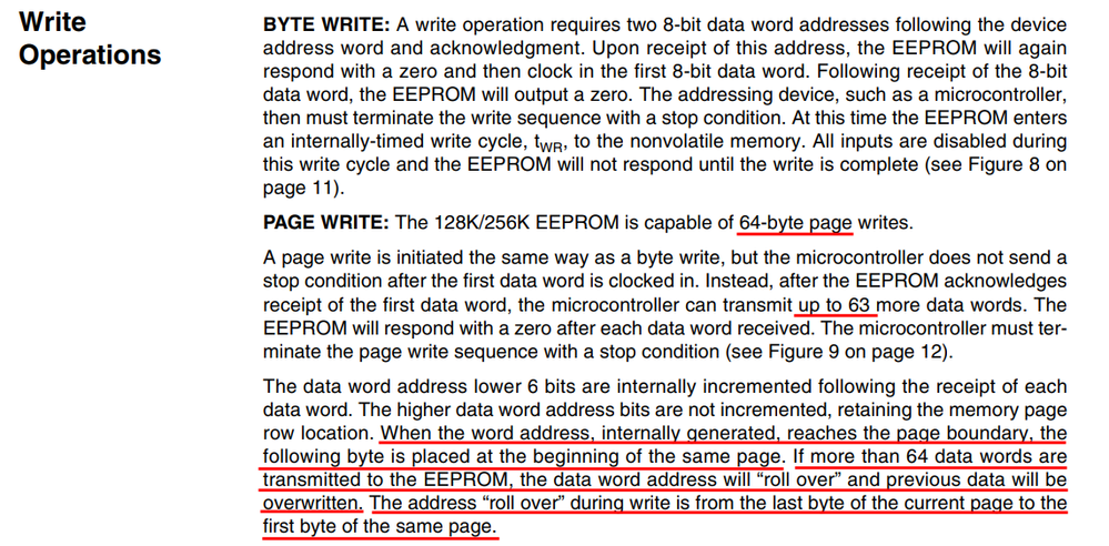

I hope someone can help me with a confusion i had in my mind right now. I work with a EEPROM 24C256 and need a write a lot of data inside , soo i decide to use the page write solution . So from the datasheet i saw i can write 64byte in one shot.
and here i have a doubt. if i start from the address 0x00 i know i can write until 0x3F.But if i start to write from 0x10 i can write until 0x3F right of course not 64Byte but 48Bytes is it right ?
So this:
The above seems pretty clear on what happens if you try to write beyond the end of the page?

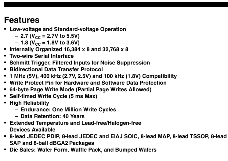

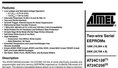

Andrew Neil
There is no such part number among ST's  24xxx EEPROMS:
https://www.st.com/en/memories/standard-i2c-eeprom.html
Your datasheet seems to be an Atmel (now Microchip) part:
https://www.microchip.com/en-us/product/at24c256c
So you really need to go to Microchip for questions about their products:
https://www.microchip.com/en-us/support
https://forum.microchip.com/s/sub-forums?&subForumId=a553l000000J2qgAAC&forumId=a553l000000J2pwAAC&subForumName=Serial%20EEPROMS%20-%20I%C2%B2C&forumName=Memory%20%26%20Specialty%20Discussion%20Group&page=1&offset=0
