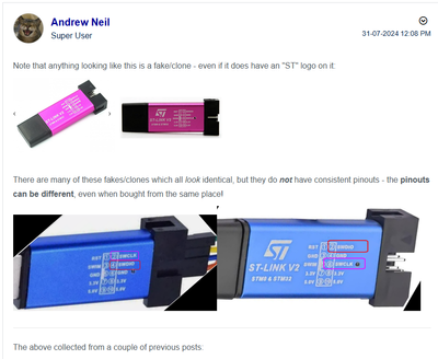

 I am using an ST-Link V2
This one? (a post from @Andrew Neil from this knowledge base article:(
If yes, that could be also another problem.

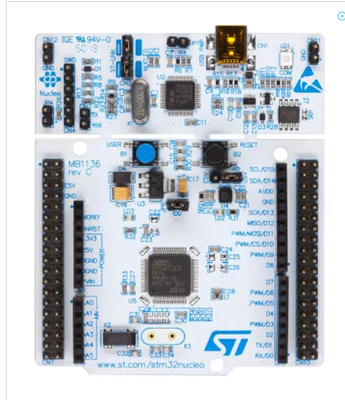

So please use one of the ST boards that contains a genuine chip and STLINK.
You can purshase: the nucleo board: NUCLEO-F103RB
It contains a STM32F103 genuine chip as well as a genuine ST-LINK:
Hope that helps.
