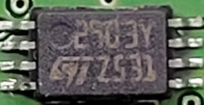

EEPROM Marking "Z531" orderable part number
p5
Is anyone able to identify this TSSOP EEPROM from the package marking "Z531"?  I'm trying to determine an orderable part number.  Thanks.
2903Y marking matches LM2903YDT--Low-power dual voltage comparator.
https://www.st.com/resource/en/datasheet/lm2903.pdf
How sure are you that this is EEPROM?
1 REPLY 1
