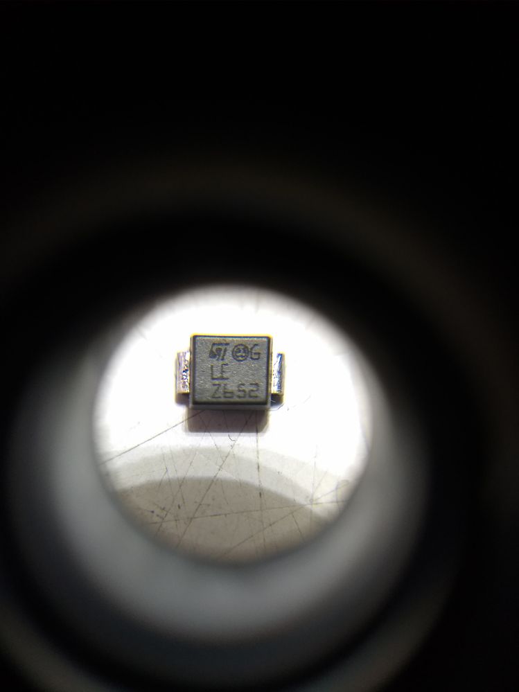

Best regards. Can someone please help me with this st thomson reference "LE652" there is no information on the manufacturer's page (st-thomson) or on the web. Thank you

ST DIODE / TVS BIDIRECTIONAL
LE
SM6T6V8CA
https://www.st.com/en/protections-and-emi-filters/sm6t6v8ca.html
https://www.st.com/resource/en/datasheet/sm6t6v8ca.pdf

Hi, Tesla DeLorean. Thank you very much.
