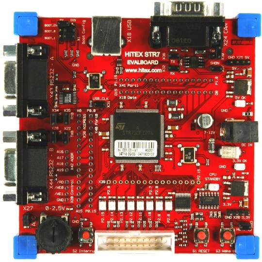

swiggers9
Posted on September 21, 2006 at 05:05
after some more research I found that the problem has something to do with the RS232 connection. I have a program which polls parameters via rs232 every 10 msec. When I haven't started the connection everything works fine and I see a noise of about 1 mVolts which is ok.
But after making connection the noise increases on the entire board with about 3 mVolts. so this explains the difference of 5 counts in my adc ((0.003/2,5) * 4096 = 4.9)
but I still haven't found the cause of the extra noise.
here are the board I'm using and the schematics.
If you have any suggestions I would love to here it.
http://keil.com/arm/mcbstr7/mcbstr7-schematics.pdf
