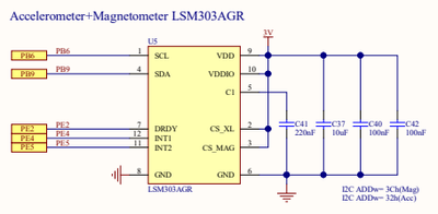

Hi, I am trying to communicate and read values from the onboard LSM303AGR accelerometer from my STM32F411VET Discovery board in Simulink. I am using a USB TTL232 RPI cable for serial communication where the three pins are connected to GND, PB6 (SCL) and PB9(SDA)

‎2023-09-06 12:26 AM
or should i connect it to PB7? it is the I2C1 RX terminal but not the SDA line for the sensor

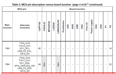

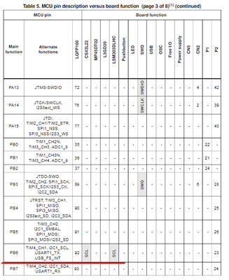

‎2023-09-06 12:37 AM
Thank you so much for the response, I will try these setting with a fresh cube mx file, meanwhile are my connections on the board correct for the accelerometer? to PB6 and PB9 or it should be PB6 and PB7?
 Your confirmation is highly appreciated.
‎2023-09-06 12:54 AM
As we can see in the table5 that you attached, you should use PB6 and PB9.
Best regards
II
‎2023-09-06 1:52 AM
Thank you, just one more question, there is also a chip select terminal but for me it is open right now. nothing is connected, but I am using the correct I2C1 addresses so do i need the CS terminal or it is correct without it also?
