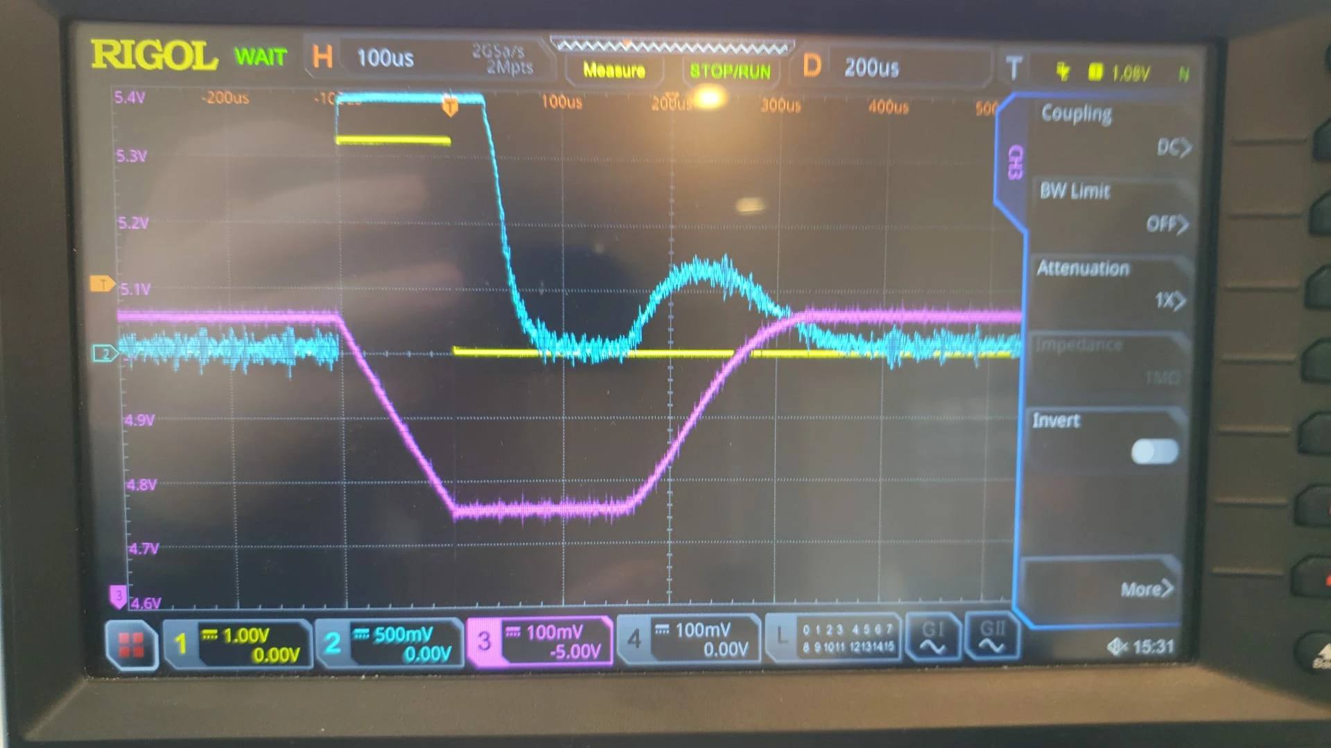

The sagging of the SMPS causes a voltage in the photodiode line like a camel hump.

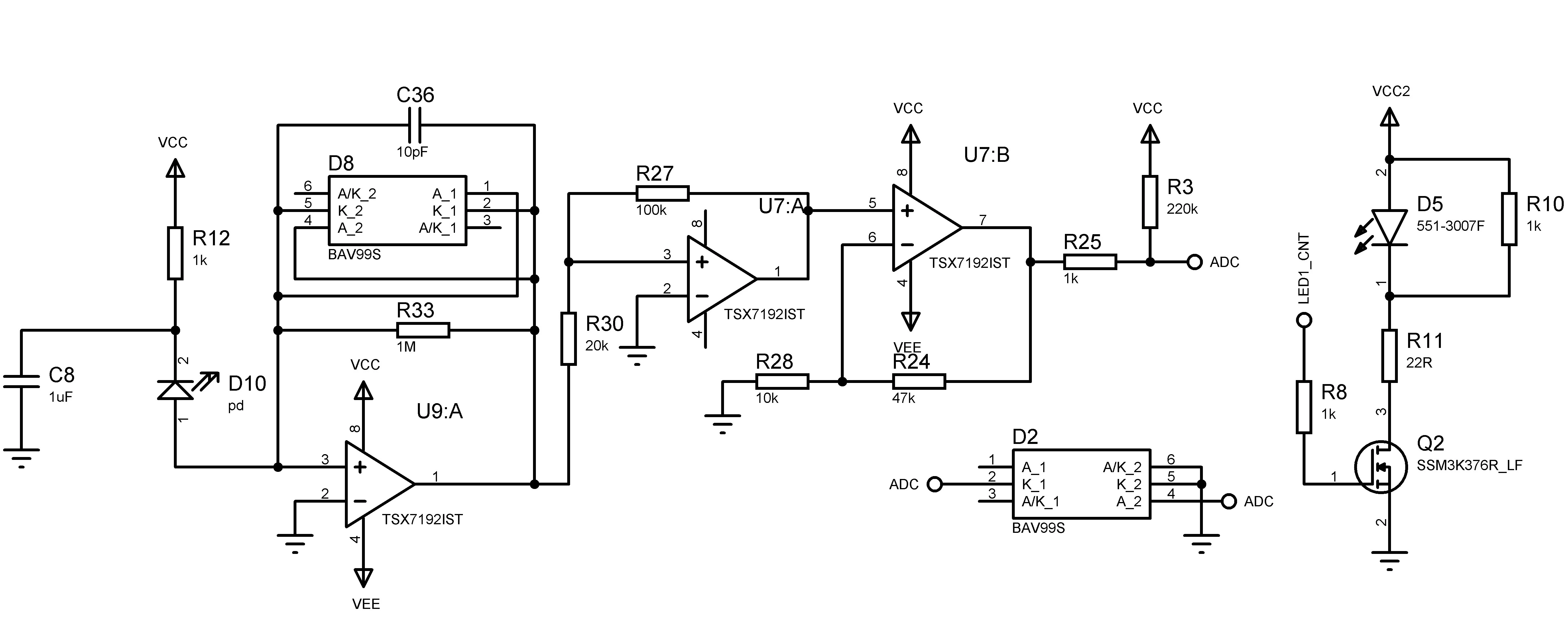

I have a system of photodiode and led to detect the presence of a substance.
I am producing 2 different 5V with SMPS for led and transimpedance amplifer.
my problem is that the led voltage sags while switching. and this sagging causes changes in the photodiode line, such as a camel hump.
I have to work with a small battery i don't want to power the led with LDO.0693W00000GWYNhQAP.jpgCH1 led switch signal
CH2 Pd ADC input
CH3 led 5V supply
how do i get rid of this camel hump-looking voltage?

Javier1
Principal
November 5, 2021
Could you share a drawing/schematic?
Where is your ADC connected to?
Why is the led 5v power supply dropping before the switching signal happens?

0693W00000GWYy3QAH.jpgthis is my circuit
1st channel LED1_CNT
2nd channel ADC
3rd channel VCC2

  1. U9:A is a transimpedance amplifier and U7:A is an inverting amplifier. Both of those must have their positive inputs connected to the signal ground like in this example. In your schematic the inputs are reversed. The connection of U7:B is correct as it is a non-inverting amplifier.
  2. If R3 pull-up is necessary at all, you should probably move it to the other side of R25 (U7:B output) so that it doesn't have an impact on signal level by forming a voltage divider with the same R25.
  3. Q2 gate probably needs some 10k-100k pulldown to keep it off, if the LED1_CNT line can be floating, but that depends on the rest of the schematic and connections.
  4. I cannot see the purpose of the R10.
  5. For BAV99S schematic symbol the names of pins 3 and 6 are swapped.
  6. D10 schematic symbol (arrows) are for LED, not photodiode.
