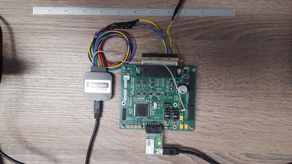

Posted on January 24, 2018 at 20:17
I did end up doing exactly what you're showing, creating a debug.wsx.  Then I point to that using the PLS UDE program to debug (instead of the SPC5Studio Perspective).  I saw several clock threads in this forum where wsx alignment seems to be the issue (debug doesn't run, but the board runs without debug).  Erwan, your posts here have really accelerated my project, and reduced the learning curve going into new toolsets.  I have many PIC projects under my belt, and I really felt like the Harmony framework that they are forcing, combined with the poor[er] customer service, convinced me to try the SPC56.  I did two avionics units using the PIC32MZ and really wrestled with it despite my experience.  So far I am very happy with the SPC56.
