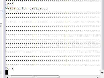

I program my SPC5 using this applications. But I have a question about main board (with stm32 which will send a code to SPC). I have a board STM32F103 and i add transceiver TJA1040. I made a program in C#, this program can send a *.bin file to STM32 board. I made a program for STM32 how should send something using CAN. I test in only in two STM32f103 boards with transceivers. And in my Engineering Thesis i should make a something like secondary bootloader. When i program my SPC5 (using your app) i can receive program and send it to BAM?
In attachment i add my application for PC and STM32 (Google drive) maybe you can show it and you will under stand what i mean, becouse I was a little lost in this.
Its like PC->STM32F103->transceivers->SPC5 board and BAM program.
Sorry for my annoying asking but its hard for me and i cant understand that.
