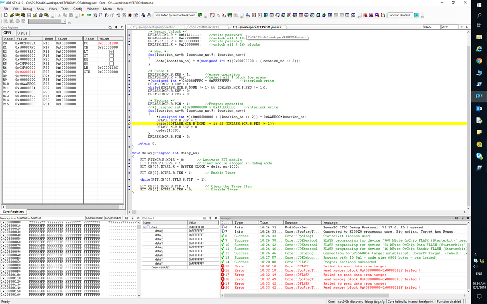

I am using DFLASH for storing data at multiple locations. Code is attached below. "READ MEMORY BLOCK FAILED" error.

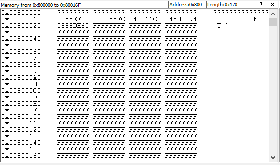

When I am trying to write word by word to multiple locations, while writing 4th word, an error is occured.. READ MEMORY BLOCK FAILED. However, next 5 locations are written successfully.
Screenshot is attached below.
I am looking forward for the reply.

Erwan YVIN
Hello ,
Could you tell more details of your Program Counter (By Assembler) ?
we do not know where the program is.
Best Regards
Erwan

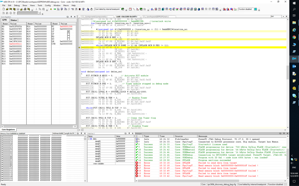

Some screenshots from PLS UDE window are attached herewith. Please help me to find out the solution. I am blocked here since last two weeks.
Thank you.
When I wrote it at alternate locations. I could write successfully. This may be due to ECC calculations (not sure though).
However, after turning the power off, I could not read the previously stored data.
Thanks and Regards,
Pooja WANI
