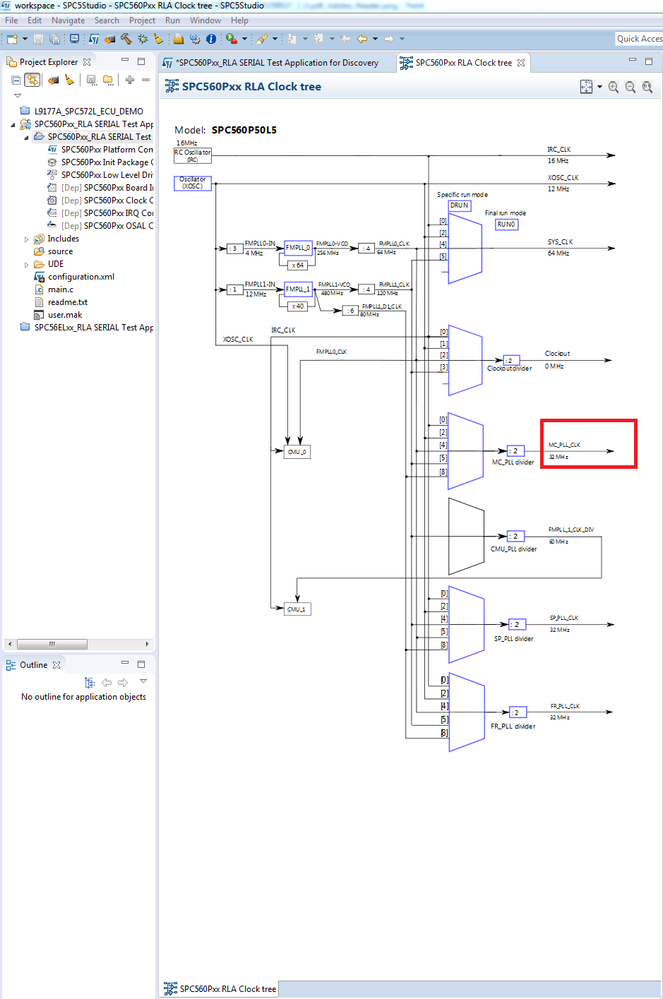

Posted on March 23, 2018 at 12:12
Dear Erwan,
Thank you for your reply.
In my project clock tree(Please see attachment) i do not see clock selection logic block for ''MC_PLL_CLK''.
Please let me know how could i add this block and how do i route this(MC_PLL_CLK) to eTimer module instead of  SYS_CLK with Prescaler 0690X0000060ACzQAM.png?

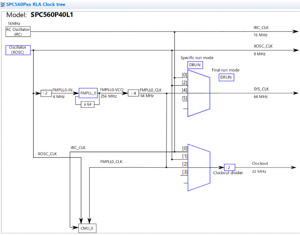

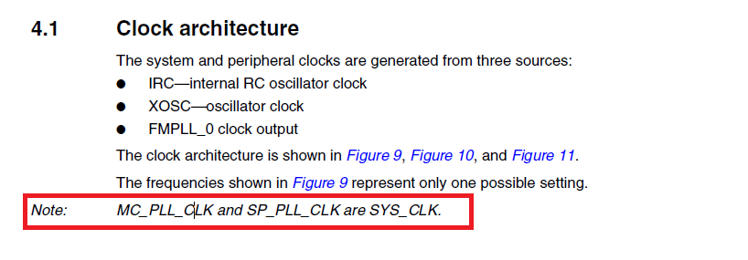

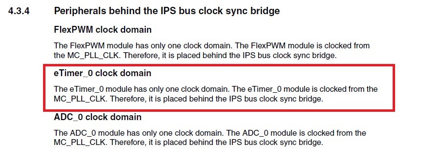

Posted on March 23, 2018 at 13:46
Hello Sathish,
for P40 Family, you should take SYS_CLK.
the clocktree is well valid (cf below)
The RM is a game of investigation ;-)
  best regards
