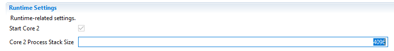

Error: Please increase the Process Stack Size via Platform Configuration Menu. (>= 4KiB)
Angle
Hi, can i know to solve this error ?
1 REPLY 1
ODOUV.1
click on platform component in your project tree:0693W00000QMhwpQAD.pngclick on runtime settings in the outline:
then set 4096 in the stack size:0693W00000QMhyCQAT.png
save your project and recompile it
