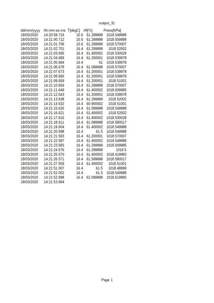

More good news! Sorry about the small print, but I have sensor data (Date/Time/Temp/rH & Pressure) logged to the SD card at a period of 996ms. I don't seem to be able to get any slower (yet) but that's fine for my tests. Expert mode->build new App by taking log SD app and changing parameters then saving as a new app.

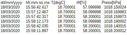

Looking much better. I have set the update to 30 seconds. It is near enough!
Updating the App seems to be more reliable at a distance of 3m. Again, it would be handy to be able to debug the upload failures one day.
Anyway, it downloads a new app most of the time and here are the latest results. 30 sec update log...

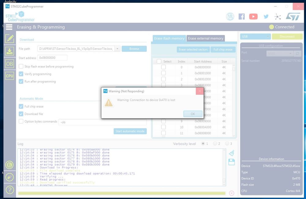

I have tried 3.3.5 but it is still unreliable on the Nexus 4. I cannot download an app in expert mode.

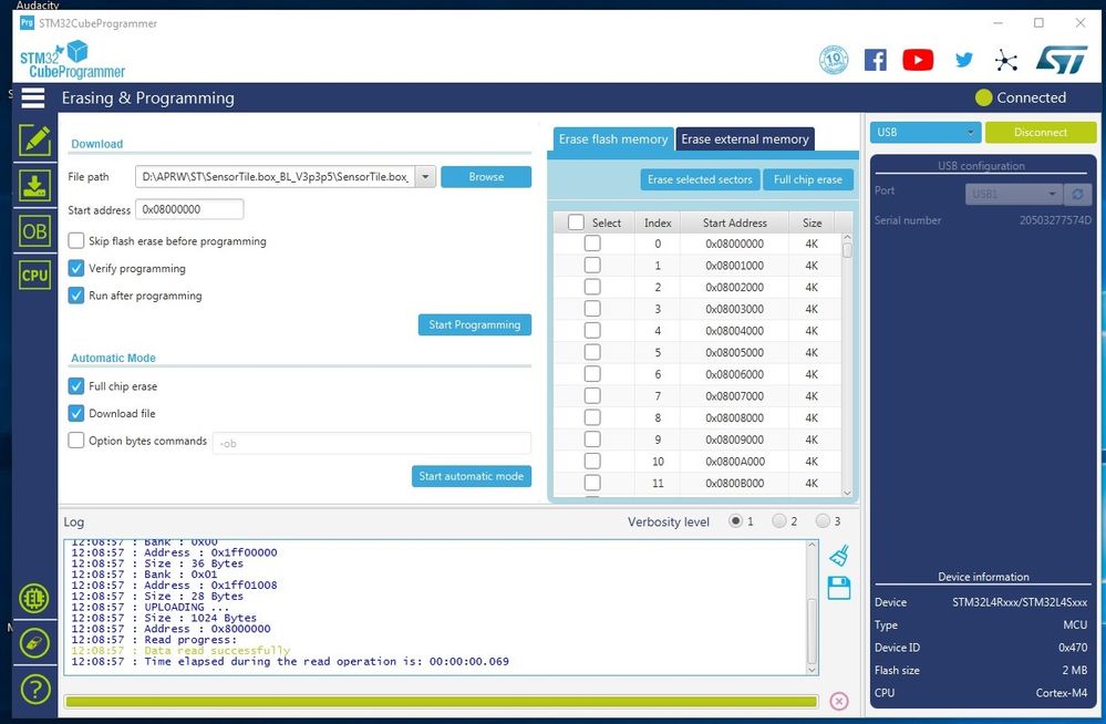

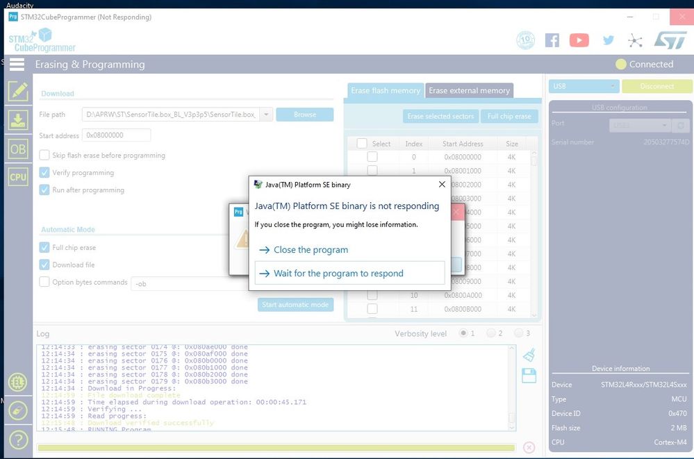

I had to use the USB programmer to get 3.3.5 into the SensorTile because 3.3.4 would not do a software upgrade via BT: it kept failing at random parts of the 700k file,

Hi @AWatt.1​ , under which point of view do you think the v334 is more reliable than v335? About the initial firmware upgrade or about the BLE connection / applications working with Nexus 4? I can attach you the SensorTile.box_BL_v334 version here below, but in general I suggest you to upload a new FW with the ST programmer in DFU mode.

Programming screen shots, in the wrong order!
