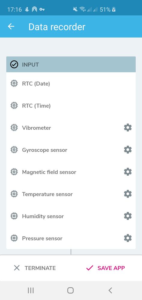

This morning's tests: I can now download apps to the sensortile.box via my Nexus4 BT, most of the time, just the occasional fail. The Environmental page now displays temp etc! So it seems to be running. The SD card via USB is detected when BT is not connected.

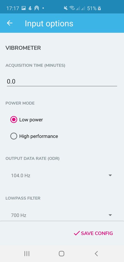

Is there a way of changing the Data Recorder app to store readings at a slower interval e.g. with the Cloud Apps?
You can edit the Data Recorder app and the ODR for each sensor, as indicated below

Some good news ;) my Nexus 4's battery discharged overnight and it did a full reboot when charged up this morning. I was now able to modify the SD log app's update times and download the SD log app with zero errors! The SD card is visible on this PC when the SensorTile is not connected via BT. Great! The log file Output_NN.CSV still has entries every 10ms so I will do some more testing by changing parameters on the SD log app. If anything goes wrong, I will reboot the Android as that seemed to help.
