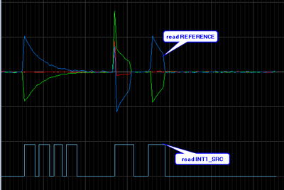

Now I have the problem, that the IIS2DH sets multiple interrupts on INT1. Reading the INT1_SRC register multiple times don't effect, that the IA bit is cleared (as described in the datasheet).

ACT_DUR       : 0x3FSometimes just one interrupt accurs, but often there are upto 6 interrupts caused by a single event. The Interrupts come up cyclic every 3 seconds.

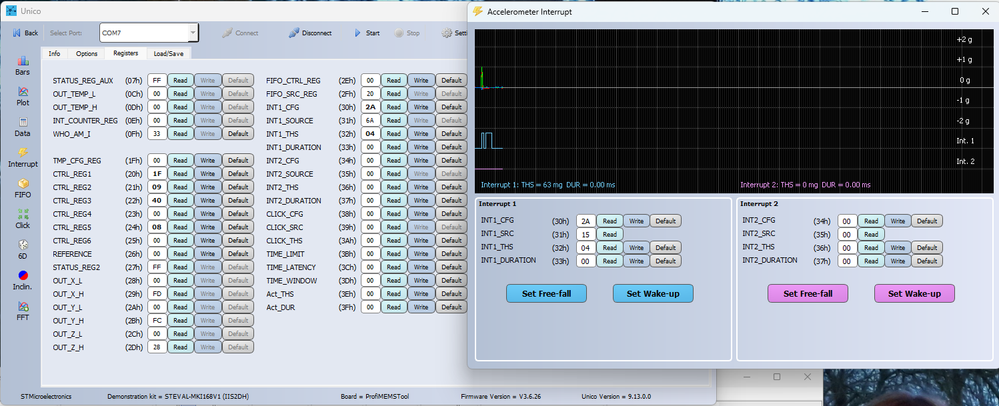

thank you for answering my question. Please excuse me for giving the addresses instead of the configuration. So here is the current configuration:

In the INT1_CFG register I have activated the "High" direction in "OR Combination" for all three axes. I also set the LIR_INT1 bit in CTRL_REG5. My expectation is that a movement will trigger an interrupt, which I can reset by reading the INT1_SRC register.
Reading at this address clears the INT1_SRC (31h) IA bit (and the interrupt signal on the INT1 pin) and allows the refresh of data in the INT1_SRC (31h) register if the latched option was chosen.
However, I notice that the IA bit remains set even if I read the INT_SRC register multiple times in a loop. So the chip seems to behave differently than described in the data sheet.
Incidentally, I can also reproduce this behavior with the STEVAL-MKI109V3 and STEVAL-MKI168V1.
After the first interrupt i read the register INT1_SRC, so the INT1 line went low, but rises again. Is there an explanation/solution for this?

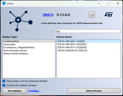

may I ask you which sensor did you select in Unico?
also, maybe the drivers change are required, even if the datasheets are pretty similar (sometimes between the Industrial and consumer version of the sensors, there are specific functions that change)
Niccolò
2023-08-08 4:22 AM
Hi Niccolò,
I have selected the IIS2DH.
My Unico-Iinstallation is
GUI-Version: 9.13.0.0
Firmware-Version: V3.6.26
Demonstration kit selected: STEVAL-MKI168V1 (IIS2DH)
Board: ProfiMEMSTool
As far as I understay the Datasheet, in this case there should be no difference to the LIS2DH. I just tested it with an LIS2DH device and have seen the same issue. So obviously we've always had the problem, it just hasn't been identified yet. :see_no_evil_monkey:
The Interrupt view from unico software shows, that the acceleration values are smoothed. If a movement is detected, the acceleration values rise sharply and then fall in an e - function. As long as this value is above the threshold, interrupts are triggered.
If the REFERENCE register is read out, the mean value is apparently reset. In addition, reading and resetting the INT1_SRC seems to be related to the sampling rate (ODR config). This would also explain why the register can be read multiple times without the line being reset.
Are these observations correct?

thanks for sharing the Unico configuration, I asked for support on that side.

thanks for your response. When reading the INT1_SRC register, the IA bit still keeps set and the INT1-Line also keeps high. After a short delay, the INT1-Line will go low. I assume, that the delay depends on the settings in the ODR. Is that correct?
I tried out to play with the INT1_DURATION. What I have seen is a delay between the movement and the INT1-Line, when increasing the DURATION. But this doesn't fix the issue.
If reading the REFERENCE resets the filter, this would be a possible way to handle with that phenomen.
Thanks in advance for your assistance.

did you try to disable the High Pass filter?
if you look at the data, it is normal that the interrupt returns high (if the interrupt is the light blue line, and if the threshold is low enough) because the data is high enough to trigger the interrupt ( can't be sure without the scale, but it seems that way)
Let me know if this solves the issue =)
