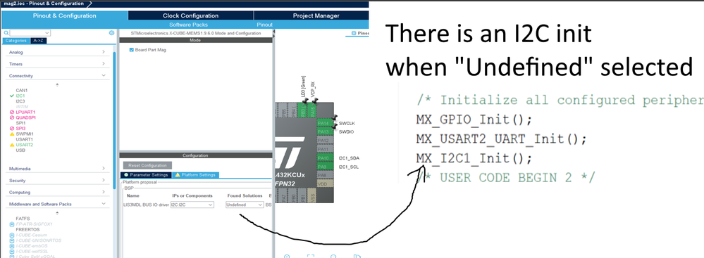

Hello!
This is what I have done yet:
  1. I started by launching STM32CubeMX and creating a new project for my specific STM32 Nucleo board.
  2. Once the project was created, I moved to the Pinout & Configuration tab. There, I enabled the I2C1 peripheral. I then set the SDA and SCL pins in accordance with the I2C configuration for my board.
  3. Next, I went to the "Software Packs Component Selector" and entered "lis3mdl" into the search bar. This allowed me to locate the lis3mdl component, and I opted for the I2C interface (over SPI) as this is how I plan to communicate with the sensor.
  4. Moving to the "Project Manager" tab, I changed the Toolchain / IDE to the one I am using (for example: KEIL or STM32CubeIDE). I also set the firmware package name and the project's location.
  5. In the "Advanced Settings" under "Code Generator", I chose "Copy all used library files into the project folder", to ensure all necessary files are available locally.
  6. After these configurations, I navigated to the "Middleware Configuration". Here, I clicked on the "X-CUBE-MEMS1", and then selected the "Board Part Mag" option which includes the LIS3MDL sensor.
  7. Within the "Middleware Configuration", I enabled the "LIS3MDL BUS IO driver - I2C" option. However, initially, under the "Found solutions" tab, it displayed "No solution".
  8. I ensured that the correct I2C bus was selected for the LIS3MDL BUS IO driver - I2C. After adjusting this, I was able to achieve "Found Solutions" for I2C1.
  9. Finally, I generated the project code.

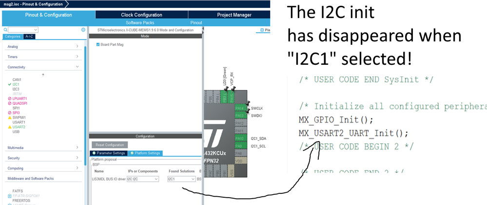

Upon generating the code, I came across a problem where
MX_I2C1_Init();
was disappearing from the generated
main.c
file when I selected "I2C1" under "Middleware and Software Packs" in the "Found Solutions" tab. However, if I left it as "Undefined", the
MX_I2C1_Init();
would be included in the generated code. This issue is obstructing my progress with the sensor setup and I'm looking for help to troubleshoot and resolve this.

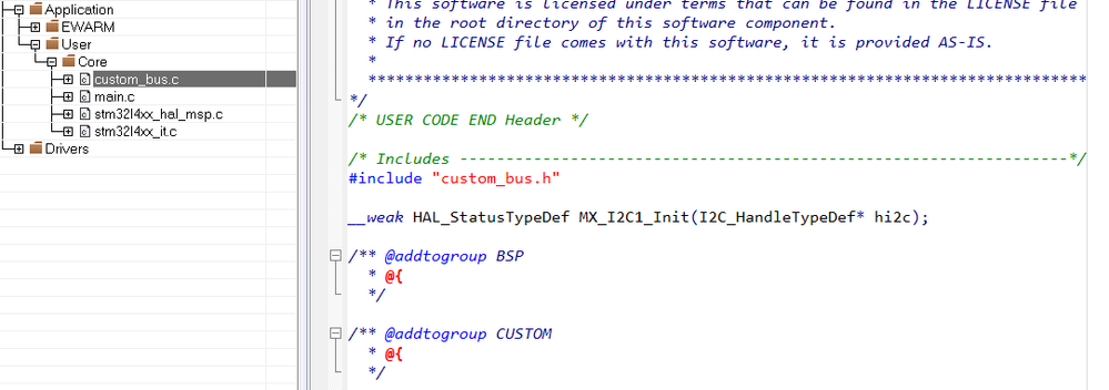

Hello @DLid.1​ ,
when you use the CMSIS pack of the MEMS, You can find the Initialization of the MX_I2C1_init(); in the custom_bus.c file not in the main.c.
