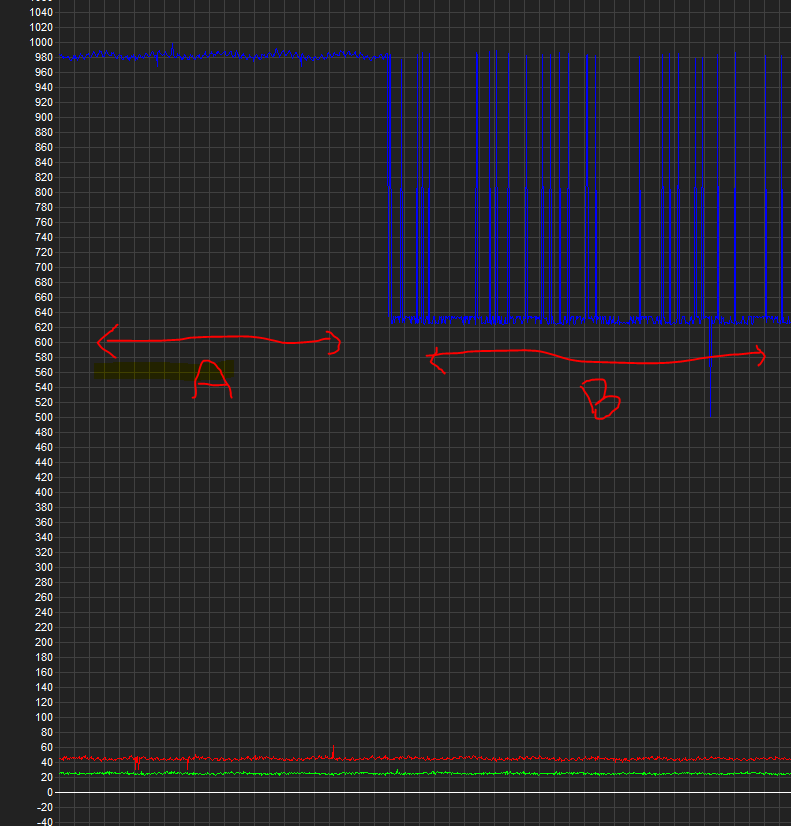

Rather than this, the problem is that noise occurs when updating block data.
If the block data is not updated, noise does not occur.
Kyouk.1
Hello...​
Z-axis data fluctuates after block data update.
Look at the graph.
Block data updata enabale case (A) and block data updata disable case (B)
This is my sequence.
Are there any errors?
It seems to be the last question.
​Thank you....

Q3) When the block data is updated, a noise signal is generated.
If the block data is not updated, the noise signal disappears.
    Is there another way?
Is it mandatory for you to have the BDU enabled?
-Eleon

Hi @Kyouk.1​ ,
it's strange that with the high pass... did you correctly configured the HPCF_XL_[2:0] and the FDS bits of CTRL8_XL (17h) register? (See datasheet, p.36)
Another way to make the residual offset zero is to use the user offset compensation method. You have to measure the residual offset in a steady state condition and then write it in the X_OFS_USR (73h), Y_OFS_USR (74h) and Z_OFS_USR (75h) registers, so that the chip automatically subtract this value to the output. You have also to set the USR_OFF_ON_OUT bit of CTRL7_C (16h) register to enable this path.
-Eleon
