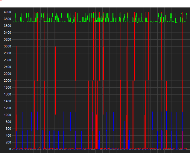

1. When there is no vibration, the X-axis shakes up to 0.1(mg)~3996(mg).
(View : Capture1 & Capture 2)
Is it negative mg because the variable declaration is unsigned?
2. When vibration occurs, the amount of change in the x-axis and y-axis is large.
capture1
capture2 (X auxi : It changes rapidly.)
X auxi : red, Y auxi : green, Z zuxi : blue

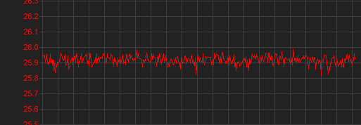

​capture3 : temperature(satisfactory fine)
I see in your last post that you are using Zigbee communication 230,400bps​
IIS3DWB has output data rate of ~27kHz (27000Hz). Each axis has 16bit data so 16 x 3 (=3 axes) = 48.
48 x 27000 = 1,296,000 bps
1,296,000 bps  >> 230,400bps​ and you have definitely some additional overhead what I see from the text log capture1
Is not it possible that you loose some data and that you bring inconsistency in the logs you are transmitting ?

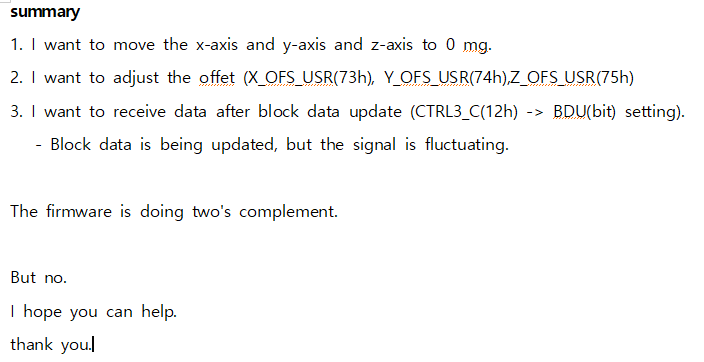

Q1) Can't you move X axis Y axis Z axis to 0 mg?
Offset cannot be adjusted.
Is there another way?
Q2) The hpf adjustment changes position, but the signal is fluctuating.
Q3) When the block data is updated, a noise signal is generated.
If the block data is not updated, the noise signal disappears.
