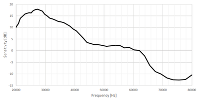

Unit of Sensitivity Plot for IMP23ABSU
TomRett
What is the actual unit (dBV, dBSPL etc.) for the plot? dB is not relative to Volt or anything.
Federica Bossi
Hi @TomRett ,
if i convert the dBV back to V i actually get Vrms at each frequency, am i right? Yes. it's correct.
Can you provide the data of the plot (e.g. sensitivity- and frequency-array)? Unfortunately, we don't provide the raw data.
4 REPLIES 4
Federica Bossi
Hi @TomRett ,
You are right, the plot is in dB.
The graph is normalized with respect to the sensitivity at 1kHz. If you want to get the dBV you need to consider that the sensitivity at 1kHz is -38dBV, and therefore add this value to that graph.
TomRett
Thanks! Can you provide the data of the plot (e.g. sensitivity- and frequency-array)? Otherwise i would have to write each value manually into each array which is not precise enough.
TomRett
Furthermore, if i convert the dBV back to V i actually get Vrms at each frequency, am i right?
Federica Bossi
Hi @TomRett ,
