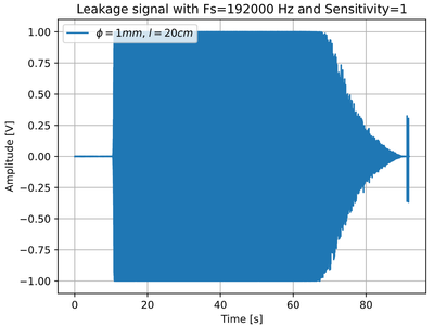

Can i reduce the sensitivity ("sensitivity": 1) for a microphone (IMP23ABSU) for it not to reach the 130dbSPL?
What does the "samplesPerTs": 1000" translate to?
Is the sampling frequency defined with "ODR": 192000" or "ODRMeasured": 192000" ? What is the connection and the difference between ODR and ODRMeasured?
That is the reason i want to achieve the reduction of sensitivity. Im measuring an air-leakage that has a diameter or 1 mm at a distance of 20 cm. The Amplitudes are normalized (x * 1V/32768). Any ideas on how to achieve this?
