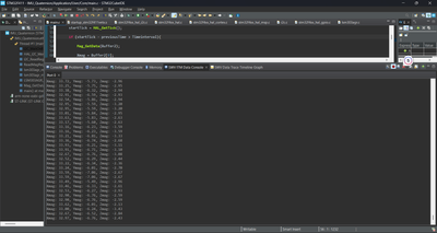

Kushal_Es
The solution provided by you is not able to solve my problem.
I'm still getting unstable readings when the board is stationery.
Here is my output when the board is stationary.
Please update my main.c file as follows:
