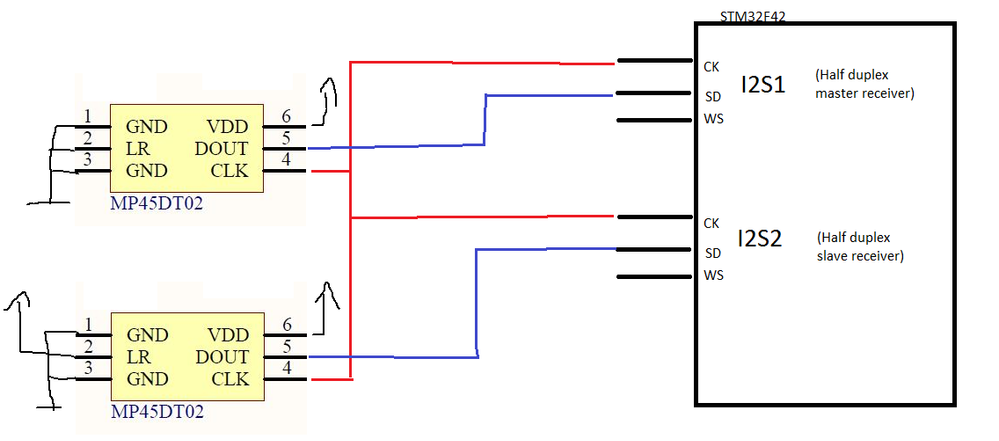

Jan Slavot�nek
March 30, 2017
Posted on March 30, 2017 at 16:05
Just for clarification: I am using MEMS microphones without WS. It has only DOUT and CLK pins ... no WS.
See picture, is this gonna work as mentioned before?
waclawek.jan
March 30, 2017
Posted on March 30, 2017 at 16:35
Oh, then you don't need to be bothered by I2S at all... Use just SPI.

Jan Slavot�nek
March 31, 2017
Posted on March 31, 2017 at 09:18
Ok so if i would use SPI, i would configure two of them as receive only slaves and i would generate clk for both of them with timer? I have looked at SPI baudrate configuration possibilities and it seems really not much - only one prescaller resulting in hudge frequency (baudrate) steps. I would prefer I2S's smooth frequency settings or maybe i will go for two SPI slaves clocked by timer PWM.
Yes i have heard about DFSDM, but i cant find suitable fast enough mcu within F4 line.
Tthere is a bug in my picture ofcourse, it should have been STM32F427.
waclawek.jan
March 31, 2017
Posted on March 31, 2017 at 13:19
Yes why not but then you need to connect WS too.
I repeat, using the 'fullduplex' I2S couples removes the need for external connecting the clocks.
