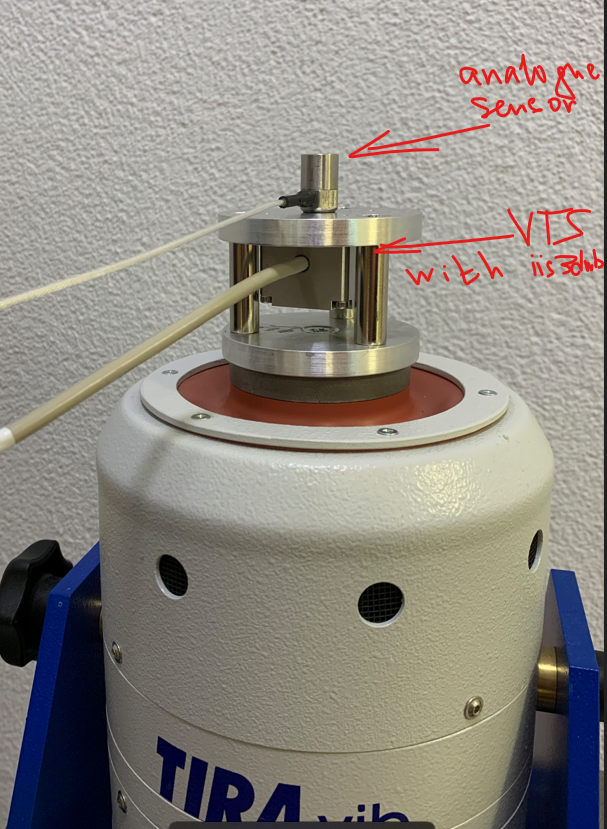

1. For tests we are using vibration shaker TIRA TV51110, control system for the shaker and reference analogue sensor verified by laser method as a feedback sensor to provide high-quality tests.

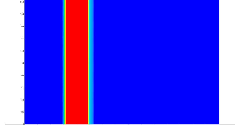

4. You can rightly ask a question about how we found it in millions of data and the answer is – waterfall. We load our csv file to PTC Mathcad then we calculate the “waterfall�? 3D chart (you will see the pictures) and with this chart you can find a needle in a haystack.

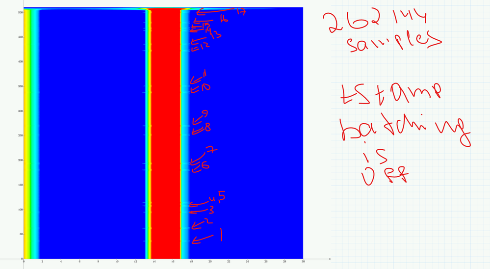

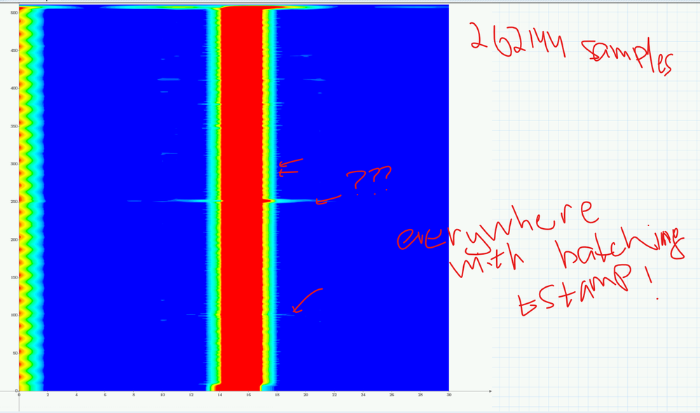

1. We put our raw data with 262144 sample num (almost 10 sec signal)  to mathcad to do some math processing. As a signal we had 100Hz sinus, 10G amplitude, we made a waterfall chart and counted 17 glitches. We were like “WTF?? ok let’s find out�?.
2. Firstly we thought that this is a vibration shaker behavior, then we snapped the signal from the reference analogue sensor and there everything was ok. Then we started to look for our-driver-bug(code mistake etc.) or iis3dwb incorrect work.

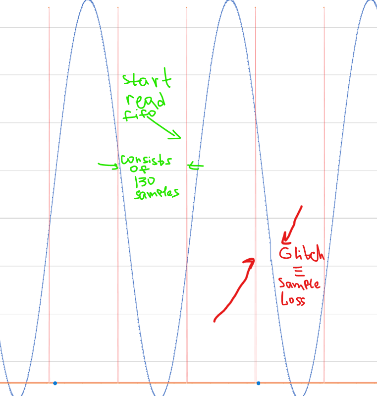

0693W00000SuH2OQAV.jpg3. We read DS and AppNote, reviewed code to be sure we prepared iis3dwb as it should be, and everything was OK, nothing was missed. We have traps for ovr and full_ia flags and we do not get into them. WTM level is equal to 128 samples. AcquireRawData procedure consists of simple steps: switch from bypass -> continuous, wait for WTM interrupt, read current fifo lvl, burst read(currFifoLevelNum), parse and wait for the next interrupt, when required amount of data is acquired -> switch back to bypass mode and wait until a new request will come.
4. To check it is not fifo overflow we have flag traps but additionally we’ve put in one output buffer acceleration data and in second buffer 1/0 flags at the beginning of data reading from fifo to mark fifo level at the moment of reading data.
And there we found: glitches were inside of the data package from fifo not on corners(which could give rise to various hypotheses), fifo fullness was at ~25% of capacity (we set watermark level at 128) and reading procedure works perfectly at watermark level we set.
5. Then when we tested tstamp feature batching to FIFO to make sure we have 37uS difference between samples and here we confirmed our theory there were differences between samples != 3 (3 is equal to 37.5 uS as I get), and started to look into the “sample losses�? side more and more. But then we again looked at the waterfall chart and found an interesting moment: with tstamp_en we have significantly more glitches idk why and very noisy signal on low frequencies. We turned it off to continue our research, and started to test other iis3dwb modes and features.

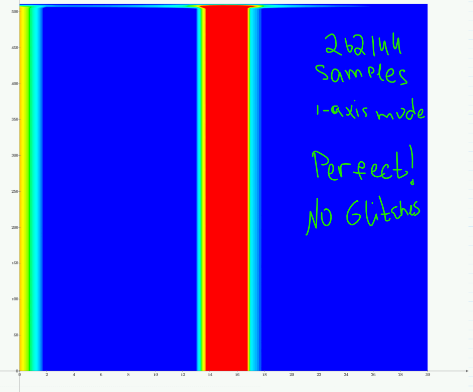

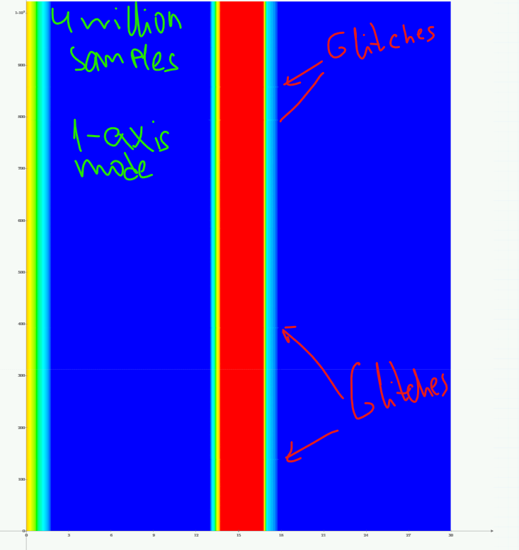

0693W00000SuH6jQAF.png6. We switched from 3-axis mode into 1 axis mode called IIS3DWB_ONLY_Y_ON_ALL_OUT_REG it’s important!!! because in IIS3DWB_ONLY_Y_ON_ONE_OUT_REG -> nothing changes and there was a light at the end of the tunnel, in a set of 262144 samples we found nothing, signal was perfect, but…

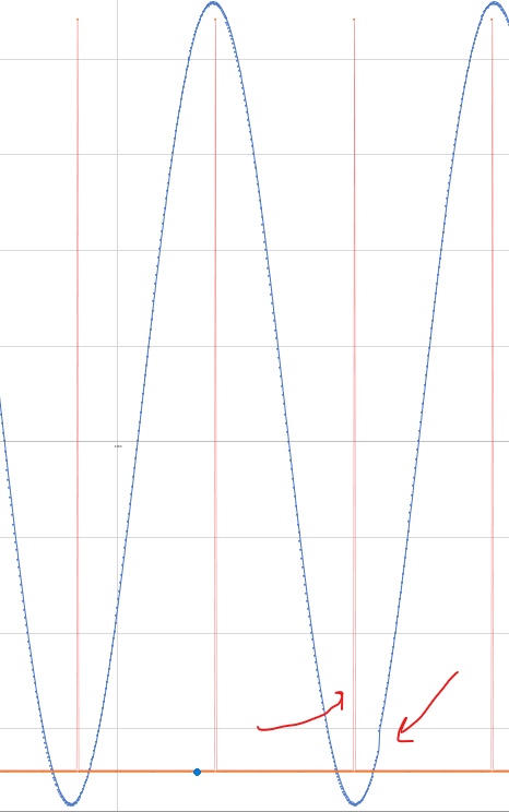

0693W00000SuH8GQAV.png7. We recorded a set of 4 million samples num ~8Mb raw data file and found 3 glitches. Yes it’s way better than before but we still have sample losses and we want it to be crystal clear (i.e. w/o sample losses). At this moment we were sure that it’s not spi issue, or code mistake or shaker behavior – everything points to the fact that the problem lies within the sensor.
0693W00000SuH99QAF.png8. To check SPI we switched from 8 MHz to 4 ->nothing changed, switched to 10 MHz -> glitches still there, then back to 8. Activated BDU feature -> nothing changed. And after all previous tests it didn't seem like spi bug. Because in this case, from setting tstamp on or from changing the mode of the number of axes, we would see the same picture, wouldn't we?
