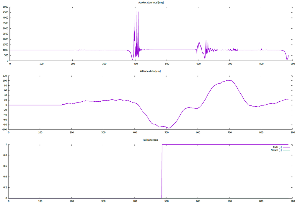

Indeed, to simulate the fall can by quite tricky.
I will explain a method which work for us:
- Wrap the board into some foam to avoid a damage when the board hit the ground
- Hold the board in vertical position (USB connector down)
- Drop the board
- Let the board still on the ground for a while
To evaluate the impact as man fall the altitude must change about ~80cm, the impact should be higher than 3-4g and the board must remain still after the impact.
Here is one example of fall detection:

Posted on October 10, 2017 at 16:32
It is not possible to tune the algorithm so far, the parameter are hard coded, but the parameter were trained on data sets captured during real man fall so it should work well.

Posted on October 13, 2017 at 14:11
You can have a look at this
https://youtu.be/8ewIRzJ9pxg
 showing our test.
I would be also good to record the acceleration and pressure and check them offline.
