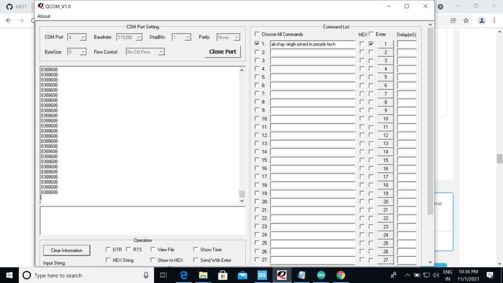

hey were you able to solve the 8404695 value issue ?
hi sir i am getting same value when i increased the load also it will not change why i dont know please give me some idea about that0693W00000GW8aoQAD.png
