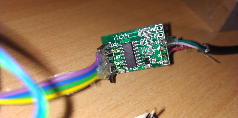

trying to interface with an HX711 load cell amp
  • June 5, 2019
  • 28 replies
  • 12409 views
The HX711 requires the MCU to send an exact number of clock pulses to capture a 24 bit value, then the clock signal must remain low until the HX711 indicates its ready to transmit again, using the data line. I tried to use a GPIO pin to generate the clock signal manually with pin_set and pin_reset calls, which works in that it creates a clock signal at the frequency of the APB, but the amplitude is only 100 mv. When I plug the clock signal into the HX711 the signal becomes low level noise. Here is the pin config:

    The following code works. Make sure that the buffer (and returned value) are defined uint32_t. The line "buffer ^= 0x800000;" is essential to avoid the huge #'s starting with 8.

    Remember that SCK high longer than 50 us resets the chip. So block interrupts before you set SCK high and unblock after you have reset SCK.

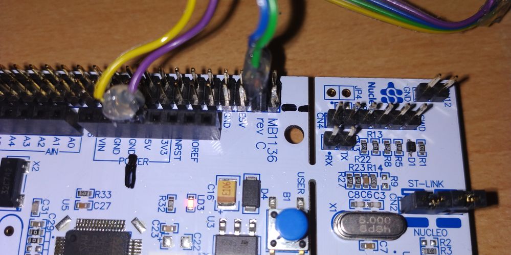

    HI BROS,
    I finally did it.Thank you for your help.
    It works properly.

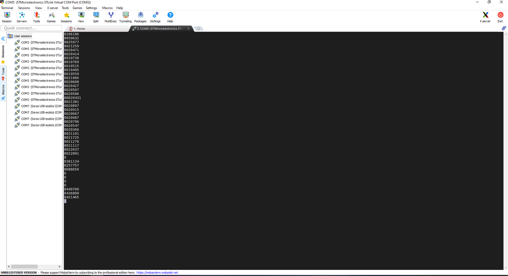

    hey were you able to solve the 8404695 value issue ?

    Hi Bro's,
    The weight values ​​are read properly, but how can I calibrate? Do you have any idea about this?
    GrantW
    GrantWAuthor
    February 26, 2020
    That you will have to solve on your own. Hint: its simple math and known weights.
