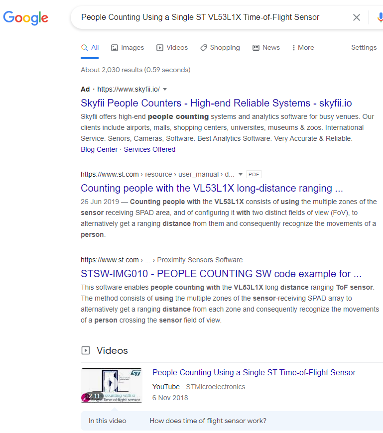

The idea is to replicate what ST did on that "People Counting Using a Single ST VL53L1X Time-of-Flight Sensor" demo.
Do you think it is possible to use the same algorithm on the L0x?
Have you tried searching to see if you can find the code for that demo ?
EDIT
1 minute with Google:
ACHOU.18
Hi ,
People couting demo is developed by single VL53L1X because of its multi field of view/multi zone capabilites which is not supported by VL53L0X. So VL53L0X is not a suitable candidate for people counting. Secondly all our SW are released based on STM32F4 and STM32L4 series.So you can choose any one of MCU and evaluate the feature. Hope it helps.
